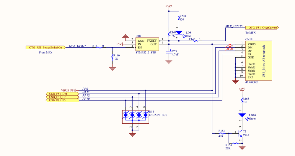

I'm using the STM32H743BIT6 microcontroller in a project, and I'm interested in utilizing USB_OTG for high-speed data transfer to LabVIEW. I've come across some schematics that involve connecting USB_OTG pins to a USB Micro-AB connector. However, I've already completed the PCB design for my project, which includes components like power supply, RAM, external ADC, and debugging circuitry. Adding the USB_OTG circuitry at this stage is not feasible. Can anyone recommend a suitable USB Micro-AB connector to the USB_OTG FS bridge or board? like the USB to UART Bridge!! Below are the schematics from STelectronics.

It's not clear to me what you're asking here. Can you put a USB connector on PA11/PA12? If not, you can't use USB_FS peripheral.
You could use a USB->UART bridge but it will be much slower.
