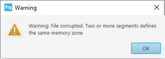

2023-09-20 1:48 AM - edited 2023-09-20 1:49 AM
Thank you for your ELF file @42Bastian Schick , I flashed it and get this error :
Best Regards,
Pierre
2023-09-20 2:28 AM

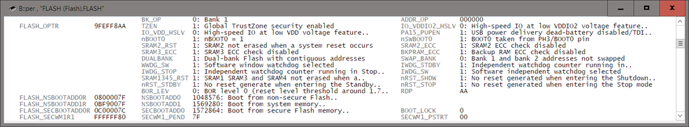

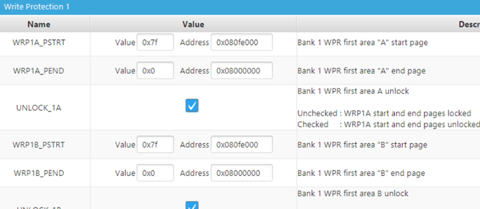

Yes there are memory regions with the same start address, but of size 0. So you can ignore the warning.
OB:
I hope above makes sense. CubeProgrammer does not allow to "dump" the OB info nicely :(
WRP2 same, only 0x081...
I attached a new ELF which I flashed w/o error/warning with CubeProgrammer.
