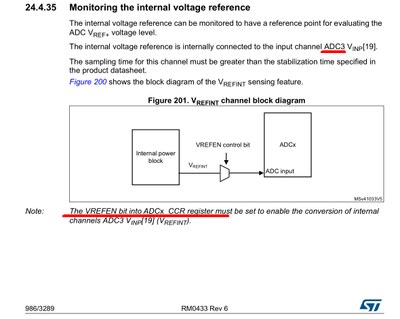

VREFINT needs to be switched on in some STM32. Also, it is not available in all ADCs in models with multiple ADC. I don't know how these details are implemented in 'H7, check RM.

Thank you for your attention to the issue. Yes,Vref is enabled. Actually I work with this the same way as I did on a previous board with STM32H743, where it worked without any problems. Moreover, I has just discovered that if I program this project to NUCLEO-H743ZI2 I get proper VREF values (around 0x627E).
