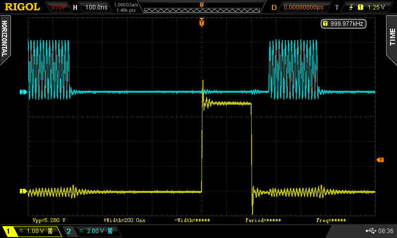

I have a TIM3 configured to generate a PWM signal with frequency 1 MHz and duration 200 ns using CC1 channel. TIM3 also generates a DMA request on CC1.
DMA1 is configured to transfer value 0xFFFF from AXI SRAM to SPI2_TXDR register, triggering transfer from TIM3_CH1.
The problem is that there is a delay of 70 ns between the end of the PWM signal and the CLK signal of SPI2. Here's the image illustrating it.
Yellow channel is TIM3 PWM signal. Blue channel is SPI_CLK signal. DMA transfer is triggered on TIM_CH1 (at the moment of the falling edge of the yellow signal). As you can see there's a delay of 70 ns, which is a lot and not acceptable in my application.
Does anyone know the reason for this delay?
MCU: STM32H743, revision V
System clock: 480 MHz
AHB, APBs clocks: 240 MHz
SPI clock: 80 MHz

Thank you!
