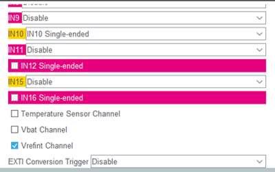

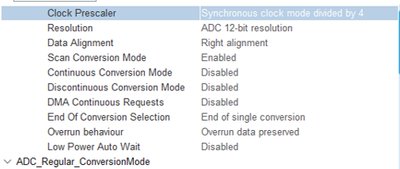

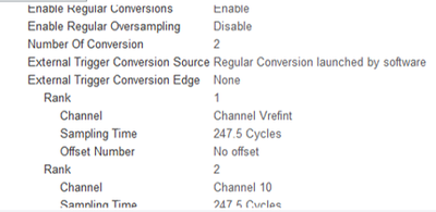

This is CubeMX config, channel 10 and Vrefint enabled:

Thanks for suggestion, however the error was not related to BLE. I managed to solve this by redefining ADC config in CubeMX, but with no changes, which is quite strange. And also, in scan mode, polling mode, where ADC conversions can timeout, is not completely reliable, better to use DMA. Maybe this is helpful for others.
