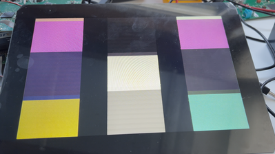

The active framebuffer (RGB565) is located in the first SDRAM bank and I can display a stable image with LTDC clock at 50MHz. However, as soon as I start to use the DMA2D (or another bus master) to write data somewhere else in the SDRAM, the display starts to show random flickering behavior (happens every few seconds):

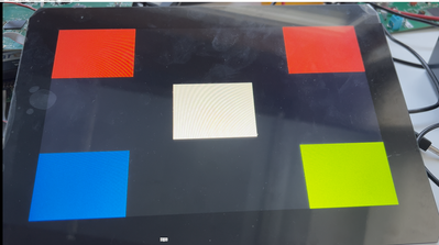

This is how the stable image looks like without flickering:

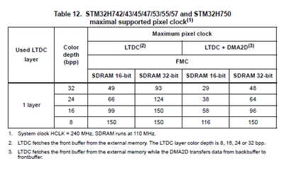

I have read AN4861 and from my understanding, my setup should work in theory given that my LTDC@50MHz is not even near the performance limit from this table:

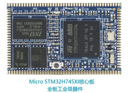

following Core Board was used .
I designed my own custom dev. board for TouchGFX experiments.
share your project and I will try to be helpful.

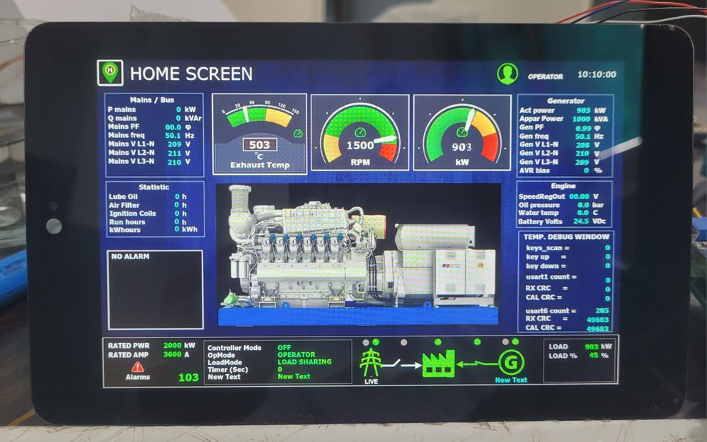

Here is my new experiment across Google Nexus 7 1st Gen , 7.0 inch TFT , 1280x800 resolution.
The Dev board is same as below .
regards
