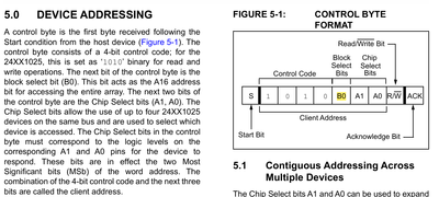

In the datasheet the method of accesing different blocks of memory or different sectors is by modifying (setting or clearing) a "bit block", is there a way of doing this using the HAL? Where should I look to modify the content of the bytes sent to the I2C device to set or clear the bit block?

The 16th bit of the address is B0 which is part of the slave address.
To write to 0x10000 and above, use the slave address 0b1010100 << 1.
To write below that, use the slave address 0b1010000 << 1.

You didn't need to modify the HAL_I2C_Mem_Read function as 16bit address works.
You need to read a little bit more about the Block bit B0. It selects the 2 blocks that are available on that EEPROM.
If B0 = 0, then you are accessing address 0-0xFFFF.
If B0 = 1, then you are accessing address 10000-1FFFF. So if you pass 0x800 for the memory address, you're actually reading address 0x10800.
If B0 = 0, then control byte (slave address) is 0x50.
If B0 = 1, then control byte (slave address) is 0x54
