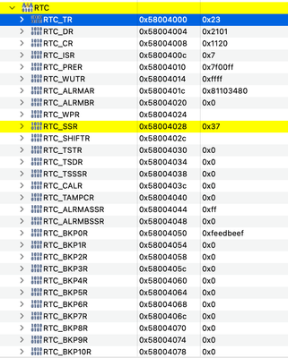

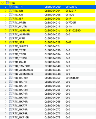

Here are the registers after I set the time & date, and then immediately after resetting (first line of SystemInit()):

I was using the debugger to reset just so I could monitor the registers. Also, it would bypass my bootloader, in order to eliminate that variable. However, just power cycling the device results in the same outcome (the clock resets, backup registers do not).
