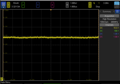

The ADC counts seem to be stuck at values which are highlighted in the picture above at around 0.31 to 0.35 V and 0.62V to 0.66V
The ADC > DR also seems to be stuck and reads 255, 511 at the two voltage ranges mentioned above
Input signal source:
Analog Input voltage range is 0V - 5V in YELLOW converted to 3.3V scale which is also the Vref
Using only RED boxed channel that is connected to the ADC pin on the mcu

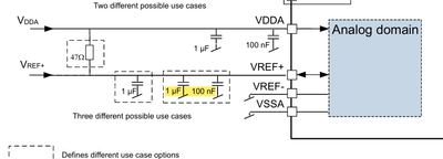

How is VREF+ connected? If you skip a cap here, or if it's unstable, you'll get readings like this.
Sahiel
Associate II
The Vref+ has a 1nF cap and it seems to be stable
The recommendation is 1 uF + 100 nF. The 1 nF isn't doing much.
