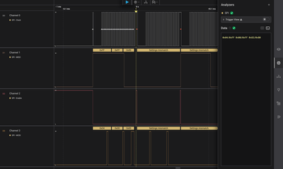

I write a configuration register and immediately read it back, but the read value does not match what was written. The logic analyzer shows correct MOSI data, but MISO often returns 0xFF or 0x80, and the SPI decoder reports “Settings mismatch”.

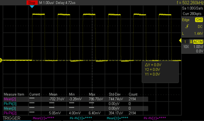

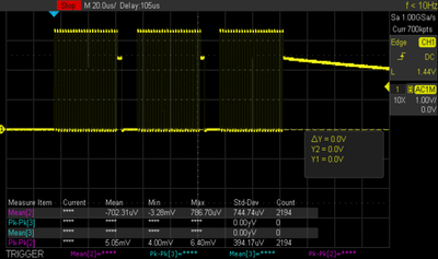

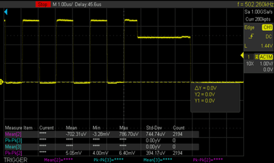

I attach some figures showing the clock signal taken with oscilloscope and all the signals taken with logic analyser.

There seems to be an erroneous SPI clock signal in the start of transmission.

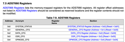

Also on the ADS7606 data sheet there is no Register with 0x04 - the smallest is 0x08.  Can you show you SPI initialisation settings.
Hi Rob,
I think the logic analyzer is reading 0x04 because the clock starts incorrectly. What’s curious is that when I checked the oscilloscope, this erroneous behavior didn’t appear. In theory I should be sending 0x08, 0x01, 0x06 and then reading the same dares sanding first 0x10, 0x01(address), 0x00(Null). The I should receive the data on that register.

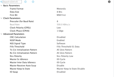

I’m attaching a figure showing my SPI initialization.
Thank you for the answer.
I think the SPI clock speed is very low - possibly too low for this device.  I'd try and set it to 20-25MHz range - you only have 500kBit which is too slow to before the conversions get to the next sample.

After SPI is initialized, do a single transfer with CS kept high. This will enable the peripheral and avoid the spurious pulse on SCK that you see in the logic analyzer plot.
Hello Rob,
Thank you, that works.
