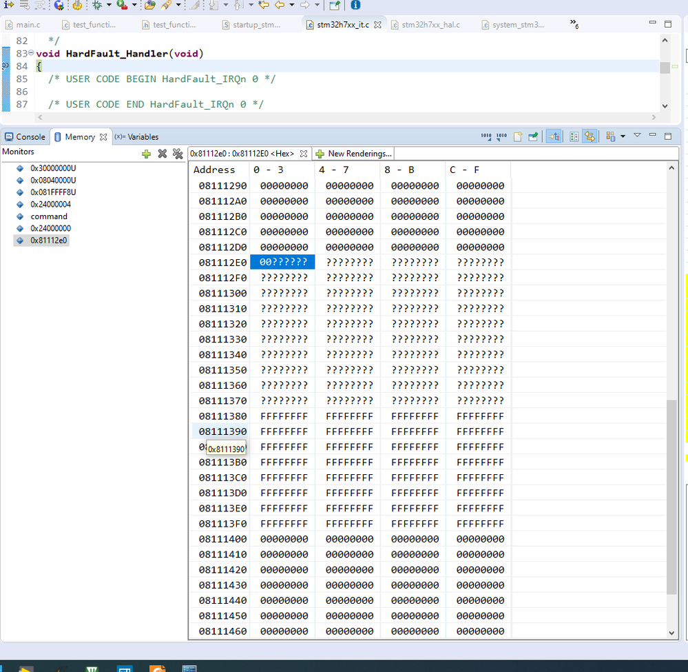

2020-07-27 4:16 AM
So I've checked MMFAR and found out that flash bank 2 has this small region that causes my program to fail, but i still don't know the reason why it can't be accessed
