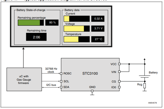

i want o create a .exe same like mentioned below,
its taken from :AN3064
I want to create a software to communicate STM32F446RE through UART1 to change the UART2 parameter setting & to see the certain variable value Declare in code.
And then need to export that page of the Software as PDF.
