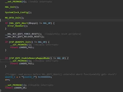

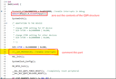

Found a resolution for this issue...
Apparently the enabling interrupts in the Init() function of the Loader_Src.c provided in the ST repository for the H7 external loader was hanging after it entered this function the first time. Made the modifications below per ST suggestion...
Once this was done however the HAL_Delay() in my QuadSPI drivers would hang (made sense since interrupts are disabled I guess) so I also had to include a local HAL_Delay() function that used NOP instead of ticks.
I added this in my quadspi.c file...
ST support is still looking into whey the enabling of interrupts is hanging in this case.

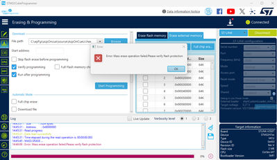

Tesla I have a mostly working external loader I developed for the Windbond W25Q64JV but for some reason the "Erase Chip" function for the external flash fails with the STM32Programmer as seen below...
This function works fine with the loader you provided for me (CLIVEONE-W25Q64_STM32H7XX-PB2-PB6-PD11-PF9-PE2-PA1.stldr) back in May 2023. Could you share your W25Q64 driver code with me so I can see what is wrong with mine?

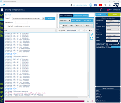

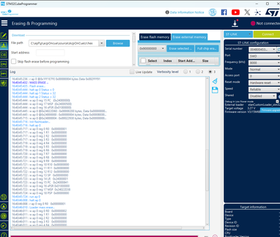

When I set the Verbosity Level to 3 the first time it successfully completed the mass erase...but now fails again. I attached the log file
The Sector Erase works fine and I could've sworn the mass erase worked fine too when I tested this back in April, but now that I have a new laptop and installed a newer version of the STM32Programmer it fails.

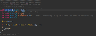

I think I found it...my System Timebase source was set to use Tim6 but the interrupt priority level for that timer was 15. I had noticed that the HAL_Delay() didn't work and I had to override it to just use a loop of NOP. But then when checking the AutoPolling timeout I saw that the HAL_QSPI_AutoPolling() was using HAL_GetTick() and I thought maybe that wasn't working right either. Sure enough once I changed the Tim6 interrupt priority to 0 the chip erase is now working. Thanks for all the discussion to help me track it down
* roughly waints for "Delay" ms before return
* set uC clock speed. Tested on M4, maybe has
* to change using other uC.
#if 1
void HAL_Delay(uint32_t Delay) {
const uint32_t clock = 400; // uC MHz
volatile uint32_t delay1; //
volatile uint32_t multiplier = 35; // that's "converting" Delay value into time spent in the below loop
volatile uint32_t k;
delay1=Delay;
for (k=0; (k<(delay1*clock*multiplier)); k++)
__NOP();
#endif

I'm not sure what's going on, starting to wonder if it is something peculiar with the STM32CubeProgrammer. I know I did several successful "chip erases" on Monday before I left and now this morning the same code is failing again. Even though the programmer reports "Error: Mass erase operation failed.Please verify flash protection" when I read the contents it actually seems to be erased. With the Erase Chip function the CHIP_ERASE_CMD is used with no addressing so I don't see how it could be trying to access memory out of range or anything.
Again all other operations seem to work fine (read, write, sector erase)
