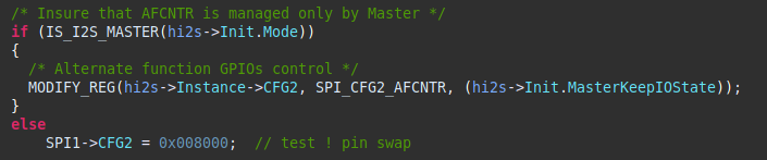

to proof , i add pinswap in HAL_I2S.c driver / init slave mode:
now sound is ok again; so data coming from SDO now (again).

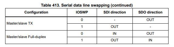

hi2s1.Init.IOSwap = I2S_IO_SWAP_ENABLE;The SPI/I2S offers the possibility to swap the function of SDI and SDO lines thanks to IOSWP bit located into SPI_CFG2. Details can be found in RM0433:
Bit 15 IOSWP: swap functionality of MISO and MOSI pins
0: no swap
1: MOSI and MISO are swapped
When this bit is set, the function of MISO and MOSI pins alternate functions are inverted.
Original MISO pin becomes MOSI and original MOSI pin becomes MISO.
Note: This bit can be also used in PCM and I2S modes.
Please see the "Serial data line swapping" table in RM0433.

and yes, to proove : i changed IOSWP bit in SPI_CFG2 , in HAL lib:
>> SPI1->CFG2 = 0x008000; // test ! pin swap
as i wrote in first post.

Adding to stm32h7xx_hal_i2s.c @ line 455
else
hi2s->Instance->CFG2 = 0x008000;solves the issue.
