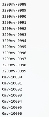

The board I am using is NUCLEO-H7S3 and I have encountered the following issues
I want to perform continuous and large data sampling using ADC+DMA, but when the collected value reaches 10000, the subsequent values become 0. When I modify the number of collected values to 50000, it stops at 17231 and the subsequent values remain 0. At this point, I am connecting the ADC pin to the 3.3V on the board. I'm not sure where the settings went wrong, please help me.
You start DMA here to get 10000 values , then wonder, why it stops at 10000 ? :)

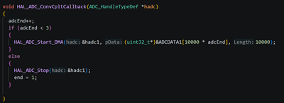

}void HAL_ADC_ConvCpltCallback(ADC_HandleTypeDef *hadc)
adcEnd++;
if (adcEnd < 3)
HAL_ADC_Start_DMA(&hadc1, (uint32_t*)&ADCDATA1[10000 * adcEnd], 10000);
else
HAL_ADC_Stop(&hadc1);
end = 1;

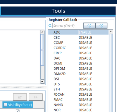

Did you enable the callback ?
Just set a breakpoint in the callback, to see its called .
Why not on circular mode ? Is the standard way, for continuous data stream.
2026-05-03 5:03 AM
Thank you for your reply. It is also possible to use the default callback function, but I don't think there is a need to use it separately. On the other hand, I used circular mode, which you can see from my project and also from the previous screenshots. I just tried this feature, but it doesn't seem to solve the problem.

If you config circullar then never you can call twice
HAL_ADC_Start_DMA(&hadc1, (uint32_t*)&ADCDATA1[10000 * adcEnd], 10000);without stop previous DMA.
Next point is GPDMA have linked lists and can store more as 65536 with use it.
And ofcourse is perfectly normal have 0 on 10000 position, because it continue on start circullary.
But back to real trouble, 17231 stop may have more source, but primary is OVR (overrun DMA) on bus.

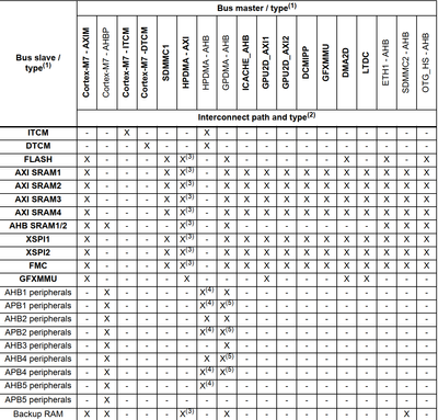

Next is as i write RAM areas. Your MCU have for example 600kB RAM, but not all parts is DMA usable. You must read pdf and use desired area for desired functions. And too 200000 u16 is 400kB, but maybe only 320kB on your MCU is ok area for DMA etc.
2026-05-04 2:06 AM
Hello, your response has been very informative for me, but I have checked the manual and it states that GPDMA can access all RAM areas except for ITCM and DTCM, and my array is not located within the ITCM and DTCM areas. I am unable to validate your idea on NUCLEO-H7S3 and may need to use DK-H7S7 for verification. I am unable to set it as the correct solution at this time, but I will reply to you immediately once I verify it successfully.
