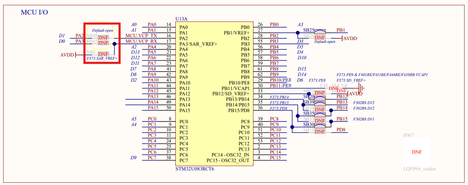

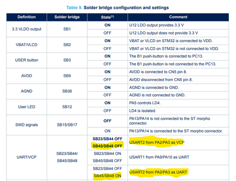

Hello @AmirImran and welcome to the community;
Could you please check the SB45 and SB48 solder bridge.
It is mentioned in UM3256 that you can used USART2 as USART if SB45 and SB48 are ON. By default, these solder bridge are open.
Thank you.
Kaouthar

Your code shows you are using USART2 which is typically the VCP port. You have not shown how you've wired the Huskylens to the Nucleo. U(S)ART is push-pull type so you can't have 2 devices, VCP and Huskylens, connected to the same USART of the STM32.
What you should do is use the Nucleo as a gateway to communicate to the Huskylens. Use VCP (USART2) connected to a terminal window like Docklight, and then use USART3 (PC10/PC11) connected to the UART of the Huskylens. So when you receive a message from Huskylens on USART3, you relay the message out to USART2 to the terminal program.
2025-03-17 6:16 PM - edited 2025-03-17 6:28 PM
I'm using UASRT2(PA2 and PA3) to connect Nucleo board to (Rx and Tx) of Huskylens. I try using other UASRT port (UASRT1 and UASRT3) but cant get any output.
2025-03-17 6:31 PM
Again, you can't use USART2 as the ST-Link VCP is connected to the same pins. The ST-Link is setting the Tx pin high so you can't have another UART Tx signal try to pull it low, else it will short out the ST-Link's Tx pin.
So instead, use USART3. I've seen several Electrical Engineers in my time, wire UART incorrectly. So just to be sure it's not a hardware issue, show a diagram on how you connect the Huskylens to the Nucleo.

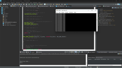

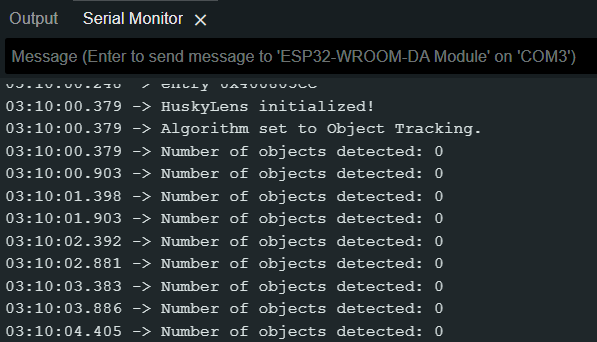

2025-03-18 10:57 PM
This is when i used ESP32 with Huskylens
This when i use ESP32 with Huskylens.
And this when I try to communicate the STM32 board.
