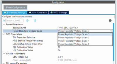

That's a good question, I've thought that option was auto selected by Cube depending on clock configuration (and yes, VDD = 3v3). When I change the main clock to 400 MHz, for example, I can only select VOS0 or VOS1.

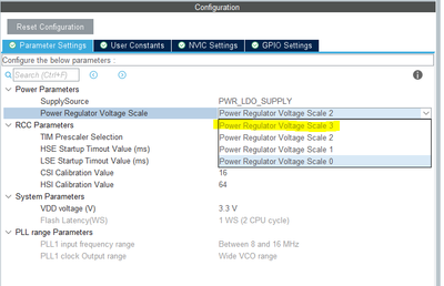

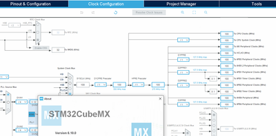

I made some tests using STM32H730VBHx MCU and STM32CubeMx 6.10.0 revision and I'm not able to reproduce the issue.
For STM32H730VBHx MCU and when the AXI clock is set to 100MHz, the STM32CubeMx 6.10.0 disactivates "Power Regulator Voltage Scale 3" option as shown in the below figure:
Which STM32CubeMx version are you using? Could you please update the latest version of STM32CubeMx tool?
