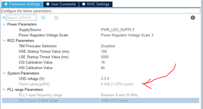

It turns out the problem was with the FLASH latency. For some reason, the CubeMX set it to 0 instead of 1 (I'm working at 100MHz), also disabling the option on GUI:
Changing it on code, now the board is starting. Is it a CubeMX bug?

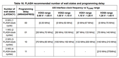

The Number of wait states (LATENCY) depends from the AXI Interface clock frequency and VCORE range as shown in RM0468 table 16.
How much the frequency of AXI peripheral are you using in your clock configuration?
Note that, It mentioned in the datasheet (table12) that the maximum AXI clock frequency for VOS3 is 85 MHz.
Could please check the AXI clock frequency value?

AXI clock is set to 100 MHz and the "Power regulator voltage scale" set by Cube is "3". So, according to the datasheet, this option should be anything but "3", as the AXI is 100, right?
2024-03-07 12:09 PM
Why is VOS3 selected when VDD is 3.3V ? Is the supply voltage 3.3V indeed?
