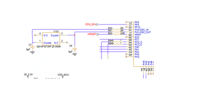

OSC
Thanks for the various answers. Above is the circuit connected to the MCU.
STlink detects 3.2V voltage.
As a result of further confirmation, the circuit is configured using a 25MHz clock, but it is not oscillating.
Vcap voltage comes out as 1.0V..!

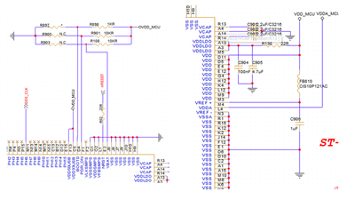

2023-08-16 8:19 PM
I set it up like the previous picture, but it doesn't work.
The smps are all connected to GND like the picture before I sent. Will this be a problem?
2023-08-17 6:24 AM
Use STM32CubeProgrammer, not the ST-Link Utility.
R130 looks like a potential problem. Inrush current will definitely make that voltage drop below the allowable.
The SMPS pins are fine if you're not using SMPS.
