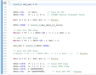

This is SPI TxRx function
SPI is working in 8-bit mode. This function is called for every byte that needs to be transmitted. For example, a packet of 10 bytes will call this function 10 times. There are faster ways of doing that, I agree. For now, Im debugging SPI peripheral problems. Initialization of SPI is the one provided by IDE Init function. Basic one, no need to go deep into this section. Cache D and I is also disabled
It transmits bytes one-by-one. After reading errata info one of potential workaround is to enable/disable SPI. As you can see, it does that but issue is still present. This code is working fine for x amount of time (logic analyzer evidence) and then suddenly it goes stuck somewhere. I have a LED to toggle at TIM interruption (25 ms) to have a visual evidence SPI is working. When SPI fails, LED remains in last state (on or off)
As also, I added a delay after CSTART is set. Not working as well
I tried to add a while loop until EOT is set to one. This is causing nothing to transmit. Maybe it is at wrong line of code. But so far it is commented out

You're writing 32-bits into TXDR, not 8, which is no double the source of a lot of issues. And also reading 32 bits from RXDR. There is a FIFO. LL has a function to send 8 bits use that or copy what they're doing, or what HAL is doing.

Now, we can notice there is an (uint8_t) typecast
SPI6->TXDR = (uint8_t)( *lp_tx_data ); <== we are loading 8 bits only
same is for reading
l_dummy = (uint8_t)SPI6->RXDR;
do you think this is the incorrect way?
even that, this code works for some amount of time and then something happen. Still I can not find where it goes (lack of lab equipment)

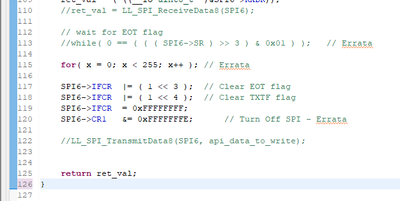

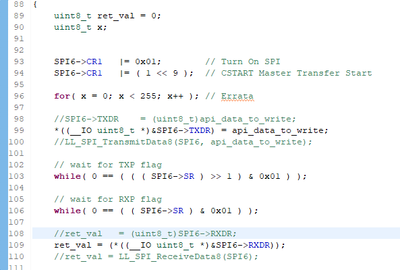

I have updated source code to use either LL or whatever is in LL function as follow;

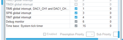

As additional info, these are interrupt priorities
I see pretty much same behavior. SPI does something weird
I have tried using HAL, LL and registers for this problem
Originally, HAL libraries were used until I observed this issue. Then I tried LL ones with same problem. Now using registers is same story

Either of these 3 options is working as expected. You and I were ok with any of these ones
ret_val = (uint8_t)SPI6->RXDR;
//ret_val = (*((__IO uint8_t *)&SPI6->RXDR));
//ret_val = LL_SPI_ReceiveData8(SPI6);
