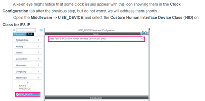

I'm trying to experiment with a Custom HID USB demo.
I'm following the instructions at:
How to implement a USB device custom HID class on ... - STMicroelectronics Community
Part way down it suggests:

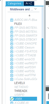

However when I got to Middleware I don't have USB_DEVICE (I just have USBX)
I can't see a way to add the USB_DEVICE Package to to the middleware list.
Help (please)?

Hi @BenG
STM32H5 natively supports USBX not legacy library. So CubeMX doesn't support ST classic library. Check this repository for ready to use examples based on classic middleware over H5.
