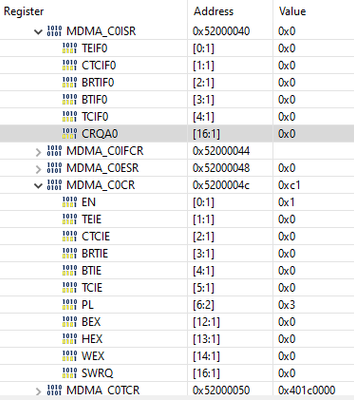

MDMA_Channel0->CCR |= MDMA_CCR_SWRQ;After executing the last line nothing seems to happen.This is the state of relevant registers:
SWRQ is not changed, nor CRCQA0. I suspect there is something in the MDMA init that I'm missing because it doesn't even give me an error flag.
Any input is greatly appreciated.
