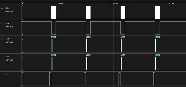

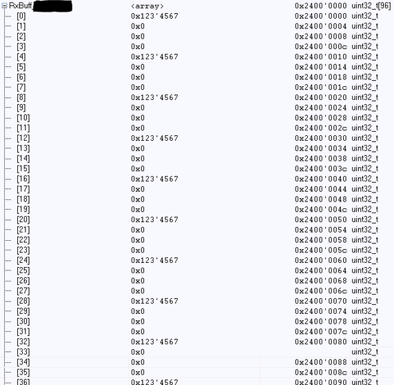

When Im using pSyncConfig.RequestNumber = 4, I am getting the expected behavior. At the current stage I am looping back MOSI to MISO and I am reading what I am sending. This is happening at the rate of LPTIM sync event at 16 kHz.
After setting up the SPI, DMA and LPTIM I am using this function:
#define SIZE_BUFFER 96
uint32_t __attribute__((section (".axi_sram1"))) RxBuff[SIZE_BUFFER];
uint32_t __attribute__((section (".axi_sram1"))) TxBuff[SIZE_BUFFER];
HAL_SPI_TransmitReceive_DMA(&hal.spi1.getHandle(), (uint8_t*)TxBuff, (uint8_t*)RxBuff, (uint16_t)SIZE_BUFFER);
HAL_LPTIM_PWM_Start(&hal.lptim1.getHandle(), LPTIM1_PERIODS, LPTIM1_PULSE_PERIODS);From oscilloscope:

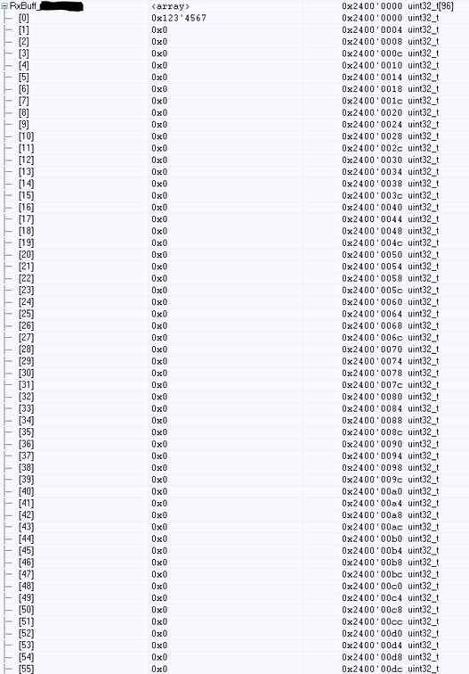

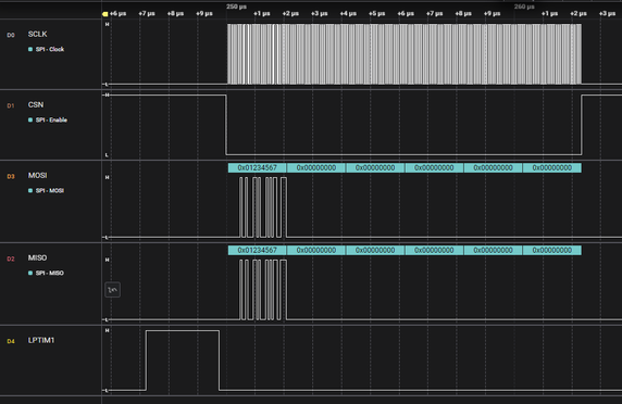

When I adjust the pSyncConfig.RequestNumber = 6.
I see in the oscilloscope that the readout is occuring at HW level:
In the live watch the buffer is only receiving the first 4 words:
In the SPI SR the peripheral is flagging overrun (OVR). There are no error flags in the ISR register of the DMA peripheral.
Is there a way I can change the settings in the DMA or SPI to have the DMA handle the data before overrun?

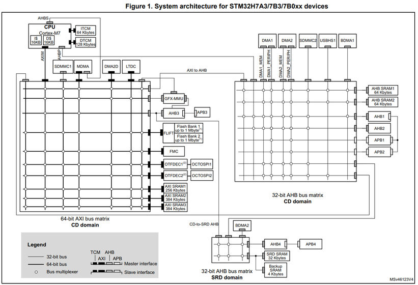

uint32_t __attribute__((section (".axi_sram1"))) TxBuff[SIZE_BUFFER];"axi_ram" is normally defined in domain D1 (look in your .ld file).
SPI1 and DMA1 can't read/write to D1. You must create your buffers in ram D2 and take the cache into account when writing/reading through the CPU.
hgl

I have tested using both AXI_SRAM(D1) and SRAM(D2). Both is working once I removed the synchronization from the Rx -line.
There is nodes between the D1 and D2 (AXI to AHB):
Using D2 memory is maybe more efficient?
2025-01-20 5:58 AM
