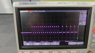

But I found that after the 1st 4GB is transferred, the frequency of QUADSPI CLK pin dropped to it half value, for example from 2MHz to 1MHz, without any error indicator. After that, the 2nd, 3rd and so on, 4GB transfer will remain 1MHz clock operation continuously. Meanwhile, the duty cycle of CLK is changed to 25%, as follows:

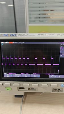

We just found that the time of frequency change is related to QSPI_AR, when QSPI_AR=0xFFFFFFFE,only 14 cycles of 2MHz CLK is transferred, than it is changed to 1M which duty-cycle of 25%:
14 cycle = 8 cycle address + 4 cycle dummy + 2cycle data

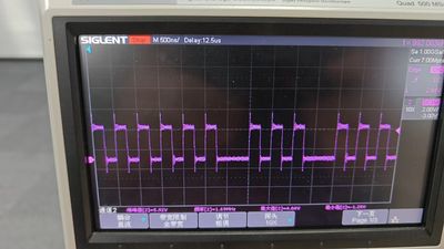

in SDR mode, after 4GB transfer, the clock will lack 1 cycle in every 4cycles:
