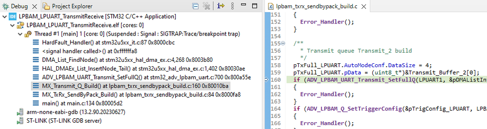

I'm trying the LPBAM_LPUART_TransmitReceive with a NUCLEO-U575ZI-Q but I can't make it works.
I enabled the debug by removing the init of PA13 and PA14. The MCU got stuck into an hardfault when calling ADV_LPBAM_UART_Transmit_SetFullQ() for the second time:
Any idea what is wrong, thanks in advance ?

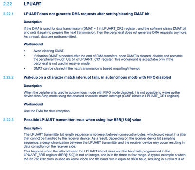

Did you look at the STM32U575 errata sheet and check if you have the known limitation related to the LPUART that could be causing this issue.

Thanks for the answer.
I follow the instruction and the transmitter board blue led never turn on.
The code should normally be correct because I didn't modify it.

I'm creating the project with example selector from STM32CubeIDE and i have verified that the code match the folder STM32Cube_FW_U5_V1.7.0\Projects\NUCLEO-U575ZI-Q\Applications\LPBAM\LPBAM_LPUART_TransmitReceive

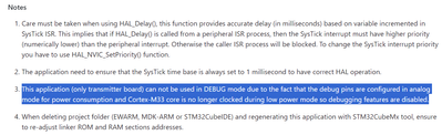

I've tested the example on NUCLEO-U575ZI-Q (MB1549) and it works as expected.
=> This application (only transmitter board) can not be used in DEBUG mode due to the fact that the debug pins are configured in analog mode for power consumption and Cortex-M33 core is no longer clocked during low power mode so debugging features are disabled.
Please check this point as described in the readme file.

I know that but with the unmodified code, the blue led never turn on.
And with debugger, the code crash before going into low power.
Would it be possible to have a binary file so i can know if i have a problem with my hardware or with my compilation ?
