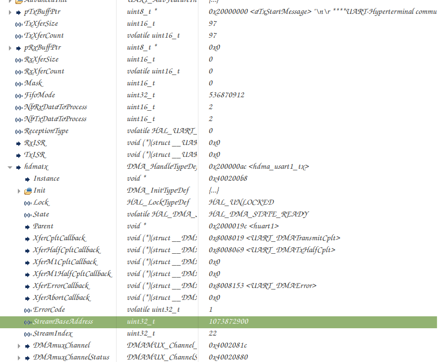

I'm using STM32H753BI. Here i'm using USART1 (PA9 & PA10) in DMA Mode. That code is generated by cubeMX and also i tried the example program of STM32H743-EVAL Board. Both are not working.

2021-05-04 12:04 AM
Tx buffer (aTxStartMessage) is at 0x20000000 and that's DTCM which is not accessible by DMA.

2021-05-02 11:13 PM
Yes, interrupt and polled version transmission is working fine.
verified the buffer address, it is correct.
HAL_DMA_ERROR_TE error bit was set while transmitting the data.

2021-05-03 9:29 PM
Thanks for your response. Here I'm mentioned the DAM Address. Buffer Address is 0x400200xx..

2021-05-04 12:04 AM
