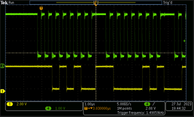

And this is what I get :
Clock is nice, and I get data from the encoder, no problem. Gaps in clock are allowed as long as they are below 15us
