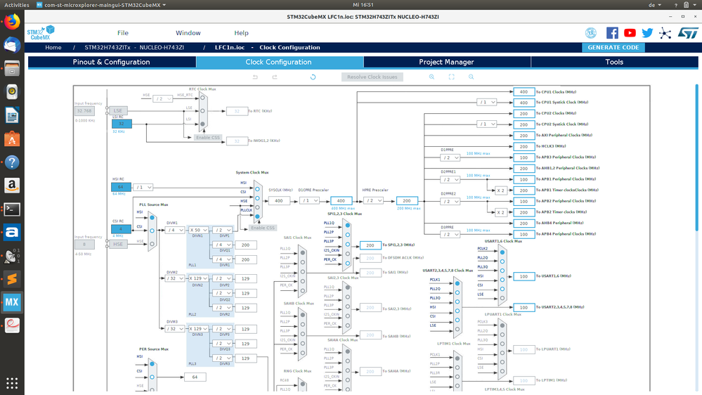

2019-03-13 8:55 AM
Hello @Amel NASRI ,
Thanks for the reply. Seems like they are. I am attaching a picture from the clocks. Any other idea? Is there any bug related with the Bus bridges that we have to workaround that is not included in the code generated by CubeMX? The SPI bugs seem to be already addressed by the generated code from CubeMX.
thanks
Best regards,
Joao
