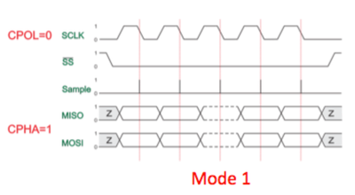

I could have been a bit more clear. Here's SPI mode 1:
Note how the rising edge of SCK corresponds to edges on MOSI.
On your scope trace, edges of MOSI are slightly delayed from the rising edge of SCK.
