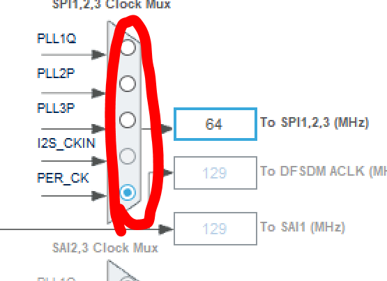

Both SPI1 and SPI5 have multiple clocks available as the source. You can use a different one and configure it accordingly.
