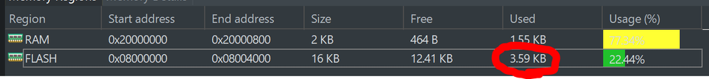

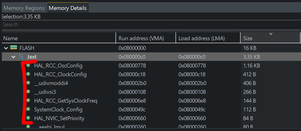

You can just use the HAL functions you want and it won't increase code size that much. Most of the space is due to complicated clock initialization functions.

The STM32L011 has 512-byte of "True-EEPROM" at least that's what the marketing/pr tosh says.. Using it here for calibration/configuration data
