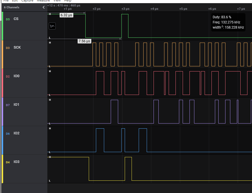

And here's a scope capture, the Saleae Logic is running at 500MHz, and the bus is 6.25MHz so I should be seeing everything. Note how the first query transfers 5 bytes and then releases CS, the next transaction transfers the command and half a bytes of data, and then subsequenct transfers transfer the command and a byte of data. (I also adjusted the PIR to be 32 counts so that we could see multiple queries in one plot.)

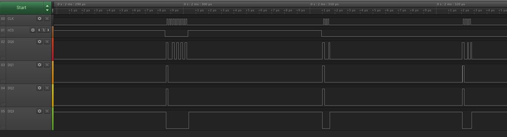

I have the same problem here. Also on the STM32H743 and in 444 mode.
For me, the 3 clocks appear when the first response to a polling request does not match. After that the 3 clocks come, and then the busy flag hangs, probably because the external chip gets messed up.
