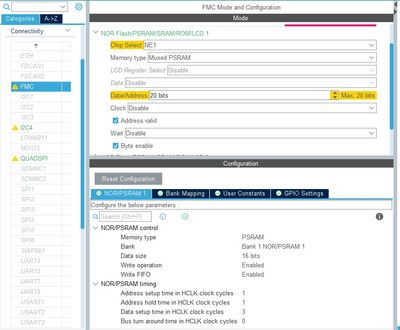

The FMC module is configured in this way:

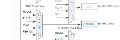

And this is the clock configuration of the FMC module:
The cpu frequency is set to 480MHz and it seems correct because I see a 48MHz on MCO1 output (with a 10/ divisor).

Check your FMC Clock and timing configuration
2023-10-05 6:56 AM
I've checked them many times and seems correct to me. I've copy/paste my configuration in my first post. Do you see anything wrong or strange?
Thank you
