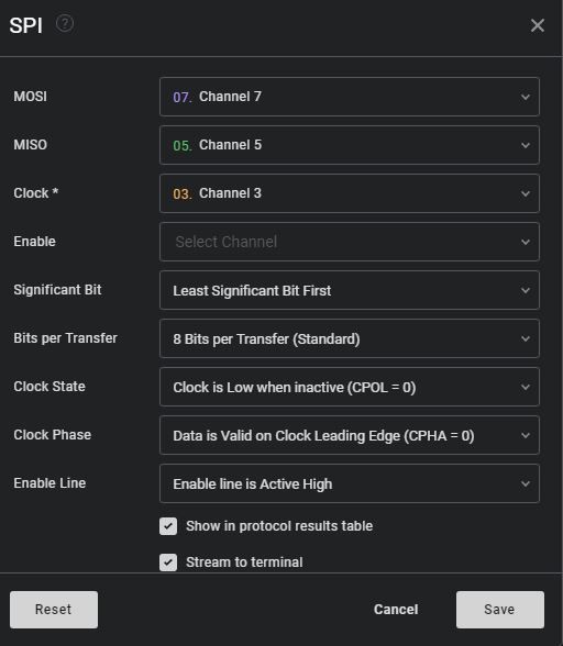

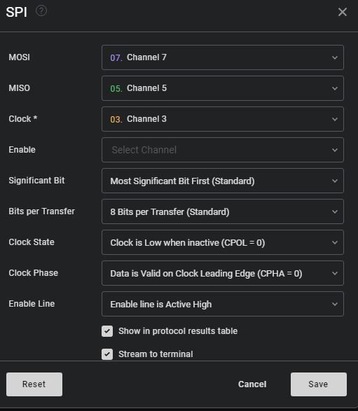

my logic analyzer is configurated as: spi_conf.JPG

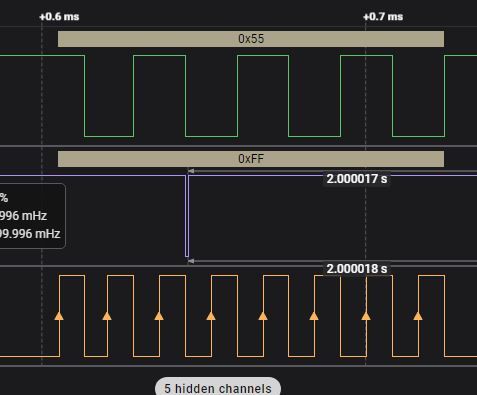

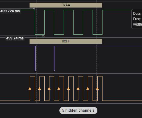

 i send 0x55 and i view 0XAA in the logic analyzer:spi1.JPGspi_conf.JPG
"Perhaps try a different pattern" ,  i don´t understand with different pattern, but i send 0x55 with library and i view 0x55 with the similar configurattion of logic analyzer, but if i put "least significant bit first" in the logic anlyzer the spi is 0x55.spi_data2.JPGspi_conf2.JPG

this spi is rigth because for send first MSB the logic analyzer view the bits inverter.
TDK
Super User
SPI is MSB first by default. Perhaps check it against other patterns that would clearly expose the difference in bit order. 0x0F, etc.
