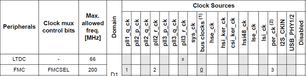

The STM32H7 series drive SDRAM by fmc,
Which is maximum sdram frequency 100Mhz or 200Mhz can run?
There are four input clock sources for fmc_ker_ck, and SDRAM clock can be fmc_ker_ck/2 or fmc_ker_ck/3.
If I choose clock source ''pll1_q_ck'' (max=400Mhz), then
SDRAM can run -5 (200Mhz)?
Or it only can choose ''bus_clocks'' (max=200Mhz), then
SDRAM run -10 (100Mhz)?

Hi
f9871006
,Maximum SDRAM frequency is 100 MHz.
In the table you show from STM32H7 Reference Manual
http://www.st.com/resource/en/reference_manual/dm00314pdf
, section 8.5.8 p. 313 table 51 , you have the constraint that the FMC kernel clock can not be above 200 MHz.So even if you put the system at maximum performance and generate a pll1_q_ck at 400 MHz (for clocking the CPU for instance), you can not use it for FMC peripheral. For example you will use HCLK3 which will be configured at 200 MHz: you can use
http://www.st.com/en/development-tools/stm32cubemx.html
and just select the STM32H743 with only the FMC activated to look at such clock tree in this simple case - see Clock configuration pane.Then about the FMC peripheral, in
http://www.st.com/resource/en/datasheet/stm32h743bi.pdf
STM32H743 datasheet section 3.15 p.28, you will find the reminder that 'The maximum FMC_CLK/FMC_SDCLK frequency for synchronous accesses is the FMC kernel clock divided by 2' (SDCLK being the clock for external SDRAM).Best regards,
