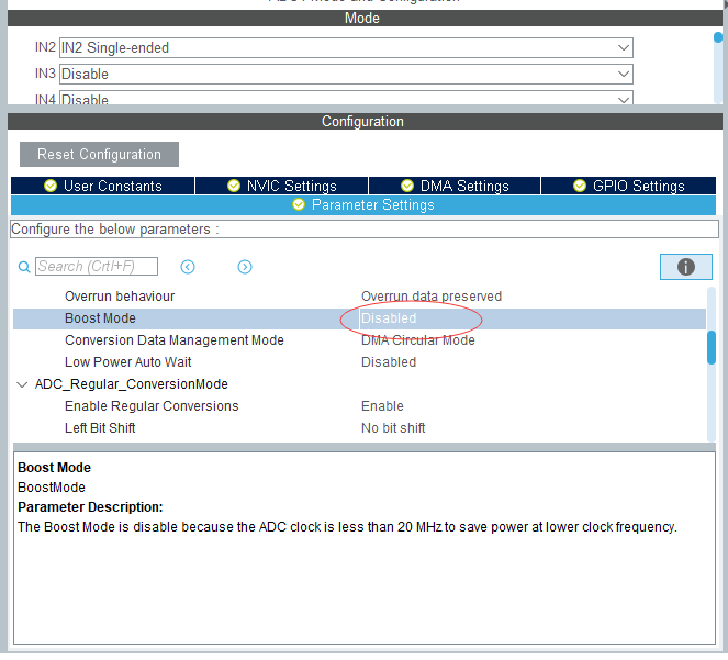

how to use boost mode,I don't know how to setting in stm32cubemx
