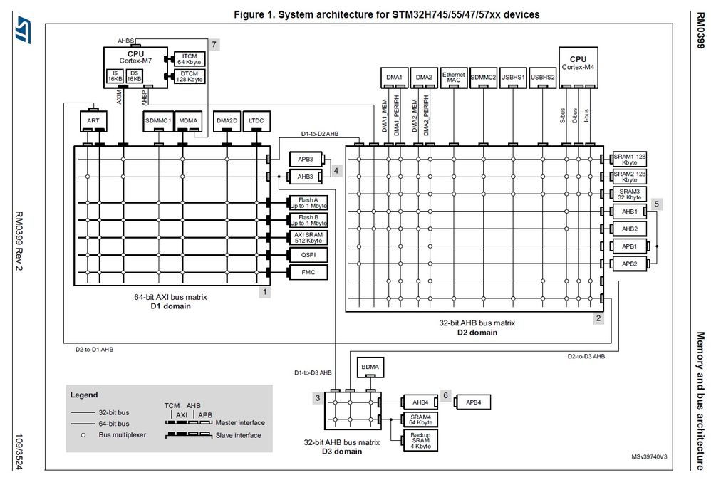

The M4 is on a bus with memory and peripheral, it is designed to manage the IO on those. ie APB1, APB2, AHB1, AHB2, Ethernet, SDMMC2, USBHS1/2
You'd generally tell the linker where you want things placed, this typically isn't communicated between the builds between cores. Best you put all your shared stuff in a struct, have that in an include file, and place it in a common view memory ie mainly SRAM1,2 or 3, further away SRAM4, and not in memory that's not visible, ie ITCM, DTCM, AXI SRAM.
