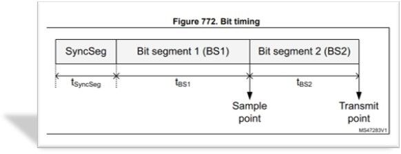

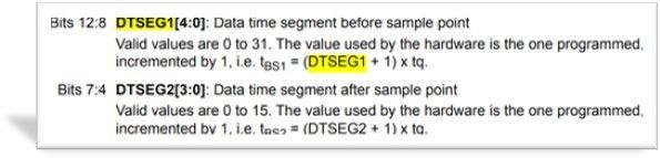

Hi @Community member,
I've heard back from the FDCAN expert regarding the documentation, and the confirmation that there is no bug and RM0468/Rev3 is accurate on this topic.
To elaborate further using Figure 772 Bit Timing, which can be found on page 2528/3357 of the RM0468/Rev 3 document.
Bit timing = SyncSeg + BS1 + BS2
Where:
Synchronization segment (SYNC_SEG): a bit change is expected to occur within this
time segment, that has a fixed length of one time quantum (1 x tq).
as mentionned 61.5.3 FDCAN data bit timing and prescaler register (FDCAN_DBTP), 2566/3357
Based on the information provided above,
Bit timing = (1 x tq) + (DTSEG1 + 1) x tq + (DTSEG2 + 1) x tq.
Therefore the length of the bit time is (DTSEG1 + DTSEG2 + 3) tq for programmed values.
Hope this clear and answer your question.
Imen
2023-03-09 3:08 AM
Ouch, now I got it. So taking the increments from the 2 register values plus the Sync_Seg is 3... That was my fault, no documentation error.
@Imen DAHMEN Thanks for clarifying! And sorry for that!

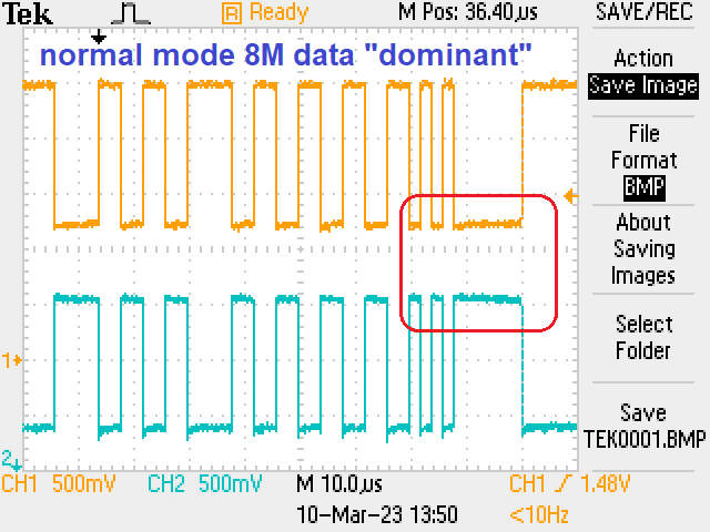

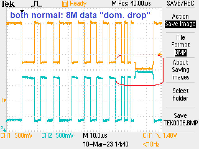

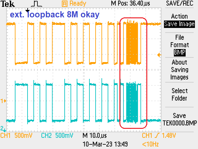

2023-03-10 6:25 AM
So here are some screenshots from my (ancient) scope.
Pic 1: one of the 2 FDCANs (doesn't matter which) is in external loop mode, this one can transmit 8M data, the other FDCAN receives data correctly
Pic 2: FDCAN in normal mode - but "alone on the bus", instead of 8M data there's only "dominant" level = 0V (for the yellow "+" side); FDF, res and BRS bits are okay.
Pic 3: both FDCANs in normal mode, instead of 8M data there's only "dominant" level = 0V (for the yellow "+" side); FDF, res and BRS bits are okay.
Here the "dominant" level at data time drops even lower, as if both FDCANs pull it down.
Pic 1:
Pic 2:
Pic 3:
