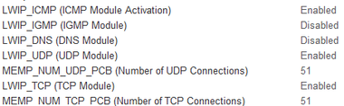

Planning to push it to maximum number of server that i can do communication simultaneously (upto 50).
Issue i faced
When increasing the number of instance intitilized, during communication controller will either run into hardfault or on the client side transmission will fail, from this i have learnt it is because of wrong memory configuration.
Currently my configuration is able to run on a maximum number of 9 clients at a time.
Assist i need
Still it is unclear to me what are the paramter that will have an impact on number of instances, especially on the memory configuration side
Update
Iam able to run the 50 server simultaneously, for optimizing memmory i want to understand the exact memory configuration required.

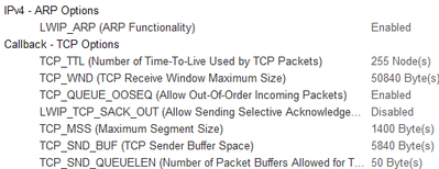

My Findings and configurations
Correct me if iam wrong, each instance requires there own tx and rx descriptors for simultaneous communication minimum 96 bytes for each.
Pbuf is for handling all the incoming and outgoing data which highly depends on the number of bytes incoming
Rx pool i dont have a clear differenciation on this with Pbuf,
The configurations are based on the referance from the above link, and i have modified some parameters which thought necessary for increasing the number of instancs.

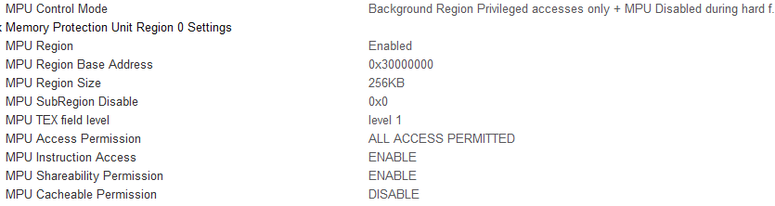

MPU configuration
Linker configuration
RAM_D2 (xrw) : ORIGIN = 0x30000000, LENGTH = 288K
.lwip_sec (NOLOAD) :
. = ABSOLUTE(0x30000000);
*(.RxDecripSection)
. = ABSOLUTE(0x30001400);
*(.TxDecripSection)
. = ABSOLUTE(0x30002800);
*(.Rx_PoolSection)
} >RAM_D2

2024-07-24 6:20 AM
Hello @STea Thanks for the replay,
I have done some digging and understood that
Descriptor Size :
RX Pool Configuration:
TX Data :
PBUF :
Memory Required For a single SOCKET is 156 bytes (tcp_pcb variable)
Amount of memmory required for a single client/server is= TX descriptor(fixed)+Rx descriptor(fixed)+socket size(fixed)+TXPbuf(variable)+RXPbuf
Here I am assuming a payload size of 110 bytes for transmitting and reception
96+96+156+110+110= 568 bytes
I was following that same referance you provided in the link and so far that is the only material i found to get some good inputs.
With the said understandings i was able to run 50 clients/servers in both TCP and UDP. Still i feel like more can be optimized and i will try to obtain more info.
Thanks for the input @STea
and i have a small doubt are PCBs allocated in the LWIP heap?
