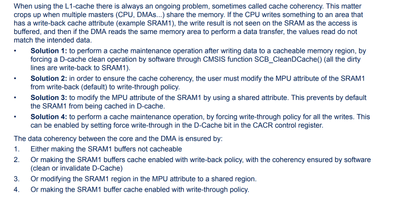

Seems you have a cache coherency issue.
Please check the AN4839 "Level 1 cache on STM32F7 Series and STM32H7 Series" especially the section 3.2 Example for cache maintenance and data coherency and how to overcome this behavior:

You need to configure the Memory Protection Unit to prevent caching of the address area used by peripherals.
