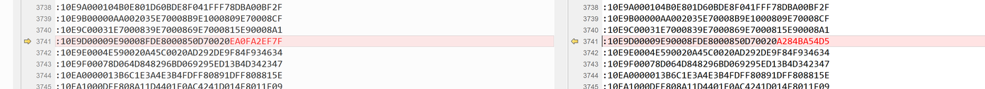

A hex file in Intel format consists not only of the data bytes, address and length, but also the checksum of the respective record. So if you change the value of CodeChecksum, the checksum at the end of the record will inevitably change as well.
Have you made a text comparison of such hex files and what exactly is the difference?

But when I build code, It doesn't changes only ".checksumdata", but also other intermittent line in hex file. How we can resolve this issue?
const uint32_t __attribute__ ((section(".checksumdata"), used)) CodeChecksum = 0x61d6714;
Expected:
Not expected:
