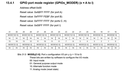

> And what configuration do the GPIOs have then?
see rm: (What they should do...except our story about PB14...so far... )
So (most) pins are at analog mode.
2024-06-18 12:08 PM
