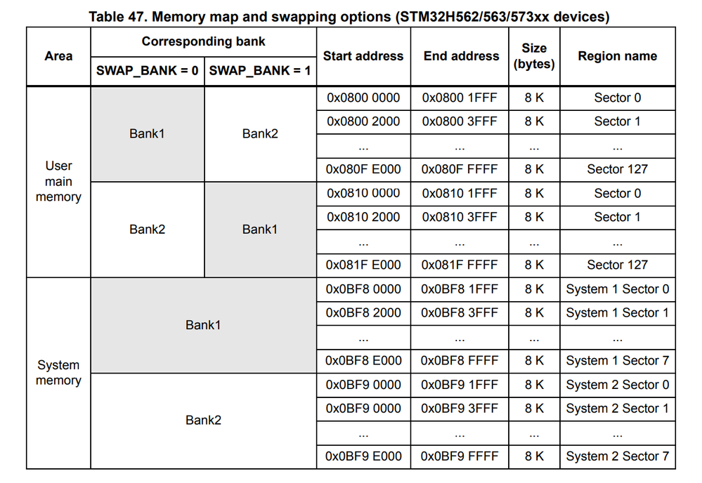

I have written the new firmware starting at address 0x0810 0000 according to the following:
I was wondering whether I need to offset by a couple sectors from the 0x810 0000 start address before flashing new firmware. Please let me know I'm mistaken, thanks.

Well if you have common code at 0x0800000 and 0x08100000 you can at least fork() between the two regions with the bank switch. Perhaps a couple of KB for a loader/recovery method.
You need to link the image for the address it's going to physically execute, not necessarily where you have it parked before it's swapped around.

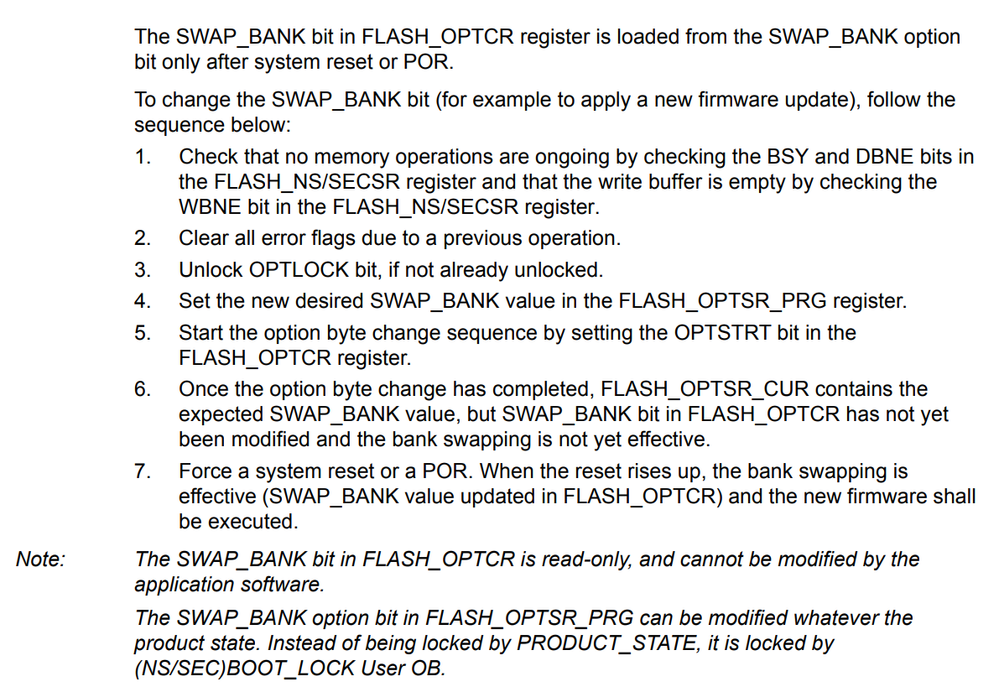

2. Then, I followed the instructions, provided on p265 of RM0481 Rev 2, to change the SWAP_BANK bit to apply a new firmware update.
3. Finally, I update the vector table offset SCB->VTOR = 0x0810 0000 before locking option control registers access and flash control registers access. However, the program terminates when the SCB->VTOR = 0x0810 0000 line executes, and the lines responsible for locking the flash are not executed.

2025-03-24 3:31 PM
The Vector Table enumerates literally dozens of ABSOLUTE ADDRESSES of functions deeper into the image.
Changing SCB->VTOR will point at a new table, and ALL active interrupts will then pivot through addresses in the NEW table, whether you're ready to deal with them or not.
a) Look at what Interrupts you currently have active.
b) Dump the content of the Vector Table
SWAP_BANK allows you to play slight-of-hand, so you can have TWO images designed to run at 0x08000000 and chose which one is active.
2025-03-24 3:40 PM
I see. I thought that changing the vector table offset via SCB->VTOR will take effect after a system reset, but that doesn't seem to be the case--updating SCB->VTOR restarted the micro instantly. I wonder whether SCB->VTOR was overwritten again by the SystemInit() function to 0x08000000. What do you think? I think I'm mixing up the order of instructions. Thanks again.

2025-03-27 12:24 PM
Unless you're running identical code in FLASH, you can't BANK_SWAP from code running in FLASH. Even calling a routine in RAM probably won't help as when it returns it's going to go to the same address in the other bank. If the code is different, expect it to crash.
I mention fork() as its the UNIX way of taking a common code image and starting a second copy of one's self.
As I originally suggested, consider a common / identical loader, perhaps 2 or 4KB, that lives in both banks, and decides which to map, and then branches in through the Reset Handler for the vector table parked at 0x08001000 (base + 4KB)
