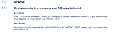

Is the DQS output is disabled?
Could you please take a look at the errata sheet and precisely 2.5.1 Memory-mapped write error response when DQS output is disabled.

looking at the schematic the DQS Pin of the flash is not used. But enabling DSQ for write operations as explained in errata sheet 2.5.1 fixed the problem.  I can now write in memory mapped mode without any errors.
