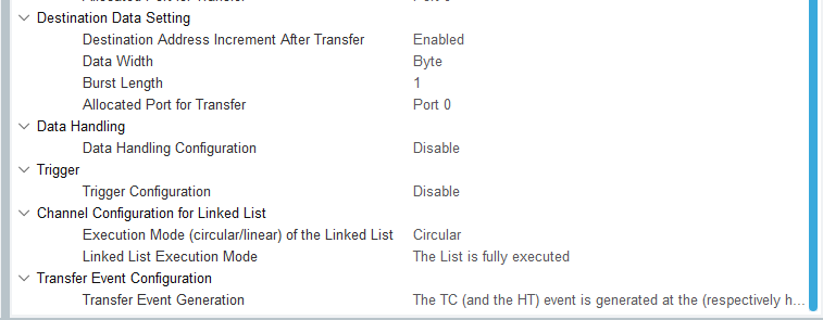

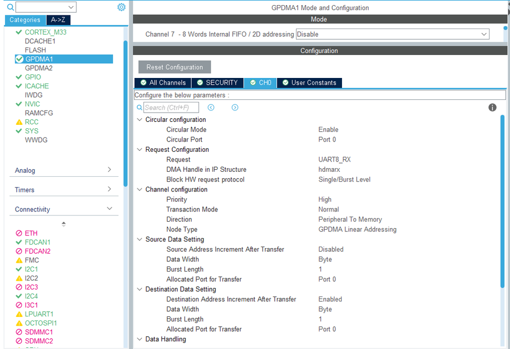

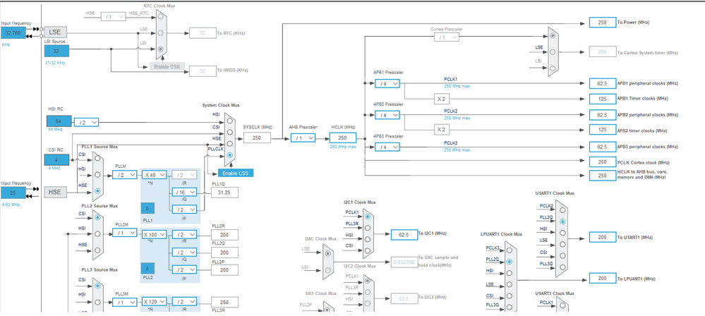

I have now started using DMA for UART reception as recommended. However, I may be doing something wrong since I don’t have much experience with DMA yet.
I am sharing the relevant part of my code and my clock configuration for reference.
Current behavior:
Additionally, I noticed something unexpected:
HAL_UART_IRQHandler(&huart8);This makes me think that I might be misconfiguring the interaction between DMA and interrupt handling, but I’m not sure what I am missing.
Any guidance on correct DMA + UART configuration or what I might be doing wrong would be greatly appreciated.

The idea of DMA (or a FIFO) ist to not have UART interrupts in the first place.
You should only need to process DMA interrupts (complete transfers of your configured size). And errors, of course.
2026-04-14 3:14 AM
@MES98 wrote:
// Re-enable DMA to receive next packageIn circular mode this is not needed. DMA can run forever. Just make sure you process the data before it is overwritten. You can do this by using a sufficiently large buffer.

Thank you all for your support and valuable suggestions.
I would like to briefly summarize the issue and the solution, in case it helps others in the future.
Initially, when using interrupt-based reception, I was able to reach up to around 4 Mbaud reliably.
After switching to DMA, I was able to increase this up to 8 Mbaud.
However, I could never reach the 10 Mbaud value stated in the datasheet — at that speed, I was neither able to receive nor transmit data reliably.
While going through the datasheets more carefully, I noticed that the UART clock is 24 MHz, and in simple terms, the achievable baud rates follow a relation like 24 / n (Mbaud).
Based on this, I tested different baud rates again:
So it seems that certain baud rates are more “naturally aligned” with the clock configuration, while others are not achievable due to divider limitations.
