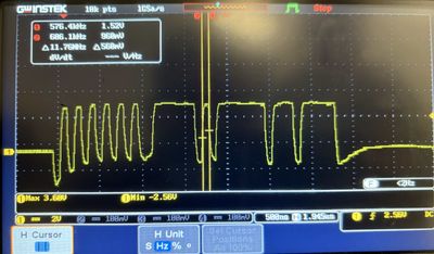

Also, those edges look rather slow
As @Ozone said, hard to tell if that's real, or an artifact of the scope and/or probe ...
@MES98 Doesn't your scope have a way to download screennshots?
That would give much better results than trying to photograph the screen!

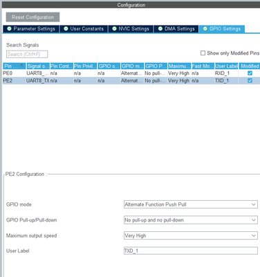

Just to be sure, what GPIO speed you set for the Tx and Rx pins? Did you set them to "Very High"?
Yes, I very much agree. Although I'm not sure how the scope bandwidth, resolution and probe attachment affect this.
Probably one of the lower-end scopes, with 2 channels, 8-bit resolution and around 100MHz.
I suppose your are aware of the Laplace / Fourier theorems, and the bandwidth requirement this implies. There does not seem much beyond the second harmonic present in the shown signal.

@Kalpak I don’t think it is causing a problem, but honestly I’m not sure why it appears.
If it were an issue, I would expect it to also affect communication at 2 Mbaud or 4 Mbaud, but those work without any problems.
Also, I am not using a long crocodile ground lead. As you suggested, I am measuring the differential lines using a very short, thin ground connection.
@Ozone You might be right. I don’t have very deep experience in this area, and my oscilloscope is relatively old, so the measurements might be affected by its limitations.
@unsigned_char_array I am already measuring it in this way :(
@Andrew Neil Unfortunately, my oscilloscope does not support direct screenshot export.
However, I can capture the signal using single trigger mode and then take a picture of the screen.
@mƎALLEm Yes, the GPIO speed is set to Very High.
You can also see it in the image I shared.
There might still be a misconfiguration in other settings though.
Yes, you guessed my oscilloscope quite well :D I am using a GW Instek GDS-1104S, and it does have some limitations.

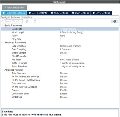

At the moment, I am planning to test using the LPUART peripheral, which theoretically supports much higher baud rates (up to 50 Mbaud).
I will share an update if I observe any changes.
Not that it's a problem. I own a Rigol scope with very similiar specs, and it works fine for most use cases.
However, you should always be aware of the limitations.

You're not so much interested in the waveform on the RS485, but rather in the signal waveform after the receiver on the STM32 side. Measure it as accurately as possible directly at the STM32's RX pin. This will help you determine whether the problem lies with the STM32 or is a signal integrity issue.
If you find that the signal is fine there, use an oscilloscope to measure its actual bit rate precisely. Next, you should verify the actual speed at which the UART on the STM32 is operating (12 Mbit is already very high and may hit the "divider" limits). You can do this either by calculating it from the values read from the registers, or more simply by sending something (to TX) and measuring it with an oscilloscope.

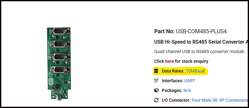

BTW: The manual for the USB-COM485-PLUS2 (Version 1.3) states:
"Serial port speed up to 10Mbps"

After checking the datasheet more carefully, I realized that the maximum supported speed is actually 10 Mbaud, not 12 Mbaud. However, I am currently unable to communicate reliably even at 8 Mbaud.
