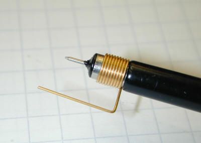

2026-04-08 8:17 PM
I see a huge negative going spike at the start of frame, at all baud rates.
Will this cause a problem for start detection?
Can you also check if the probe ground is connected by a very short wire to circuit ground? Not the usual long tail crocodile.
2026-04-08 10:58 PM
Basically on every falling edge.
I suppose this is an artifact, because the probe and the way it is attached are not appropriate for RF.
Mind you, a digital (square-wave) signal requires a bandwidth significantly higher than the bps number.
2026-04-09 1:40 AM
@Kalpak wrote:I see a huge negative going spike at the start of frame, at all baud rates.
Exactly.
OP needs this:
This should reduce ringing from probe ground inductance.
