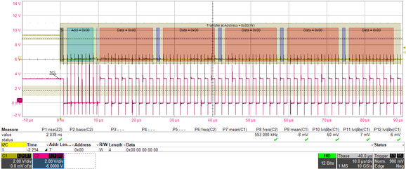

After STM32H5 I3C initialized as a controller, without any IBI, HotJoin Enabled, pull low SDA line will case SCL unstopped-toggle, as figure

I am using demo board [NUCLEOH-563ZI] for my Hardware without connect any slave device,
I keep pin PB8(I3C1_SCL), PB9(I3C1_SDA) floating when power up, and then pull SDA to GND cause SCL unstopped-toggle, as figure above

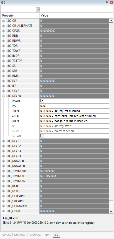

I think I am not enabled either IBI or HotJoin, here is my I3C registers after initilized, did I miss something?
