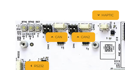

2024-02-16 5:18 AM
@mƎALLEm Their web page says: "Fully independent 2xCAN FDs Applicable in industrial and automotive area."
https://riverdi.com/product/7-inch-lcd-display-stm32h7-frame-rvt70hssfwn00

Ok since the board features CAN transceivers, (and apart of previous questions) you need also to check the two termination resistors of 120 ohm connected to the bus.
Check also the wires continuity of CAN_H and CAN_L on the transceivers' pins.
What is your FDCAN ker clock?
Please provide your ioc file.
