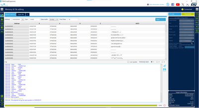

Hi, I'm trying to do an external loader according ST's MOOC and this forum https://community.st.com/t5/stm32-mcus-products/stm32h5-external-loader/td-p/601134.
My code pass on all ST's tests of memory, but when I generate a stldr it does not read on cubeprog.
I attached my project and log of cubeprog.
I already do the same with a G474 without problems.
BR

The log implies Init() failed, so might want to instrument that
I'd expect Write() needs to leave with memory mapping, depends what STM32 Cube Programmers expectations are to be able to read the memory directly, as NOR_FLASH does not use Read() function.
